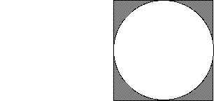

Ron,
If you want the work surface to be 36" on a side, it will take a circle of a diameter 1.7 times the length of a side, or 61" for the corners to swing around in. Guess how I learned this! You could "inlay" a 36" dia circle mounted on the LS, and surround it with a stationary square surface (grey area), saving space. But maybe you thought of it already.
burbank38831.5772106481
PostPosted: Mon Apr 24, 2006 5:05 am
Posts: 1075
First name: Coe
Last Name: Franklin
City: Decatur
Nifty idea, Pat!
